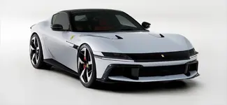

The Ferrari 12Cilindri (Type F167) is a two-seater front-engine, rear-wheel-drive grand tourer produced by the Italian sports car manufacturer Ferrari. It was unveiled at Miami Beach on May 3, 2024, to coincide with the 70th anniversary of Ferrari in the American market. The 12Cilindri is the successor to the 812 Superfast.
FERRARI 12CILINDRI: FOR THE FEW

I am disappointed with this model. The design is bold and innovative, but looks odd and messy. Not as ugly as SF90, but Ferrari can do a lot better. And then we have the engine which is the same as previous model with same ps, it’s not any faster than before.

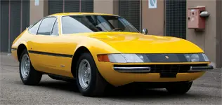

It really looks stunning. Love the front light grill retro connection to the 365 Daytona. 9500RPM NA V12 is a work of art and will probably sound amazing. Not sure I like the interior though.
